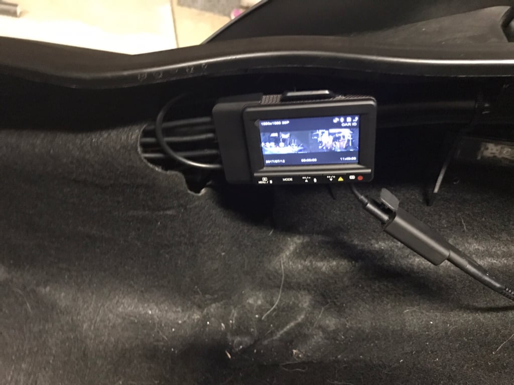

    As I understand it the screen can display video for playback but it is primarily for setup and working through the menus. I've seen a couple riders put where visible but most put under seat or in compartment where protected from elements.

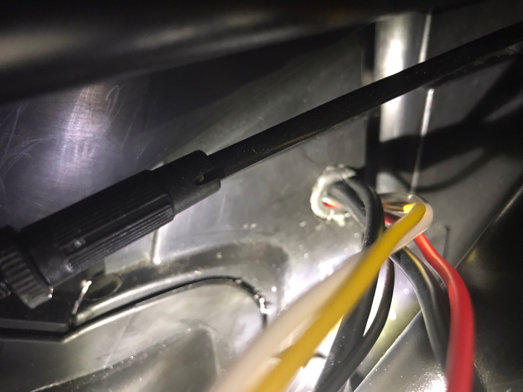

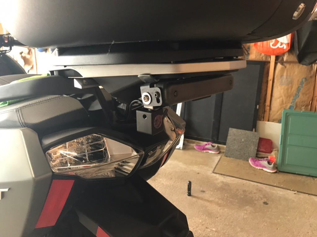

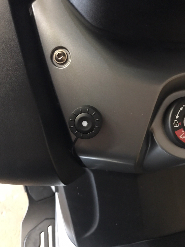

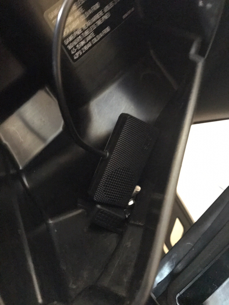

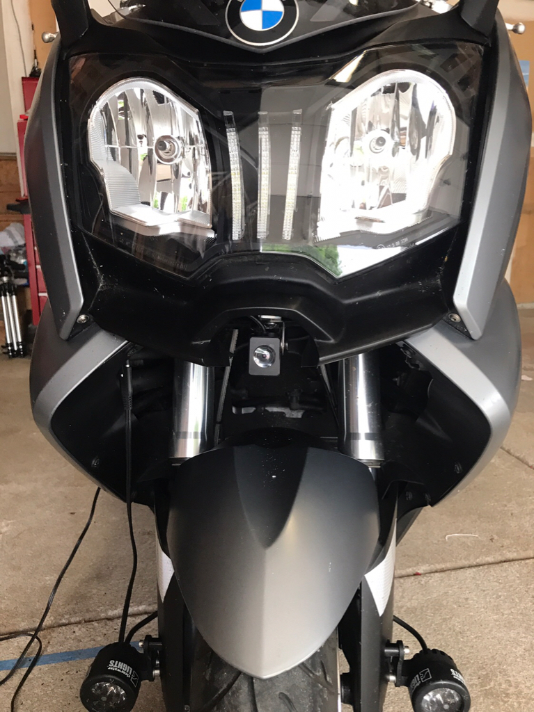

    Installation of "dashcam" DVR system mostly completed last night. Need to finish hardwire of power, wires installed but need to wire in relay, using underseat power plug to test for now. Also need to tweak the camera mount in front. DVR box underseat, camera front and back, GPS and speaker in right box and record save button on dash. Everything ended up pretty neat and clean. Will post some video once I ride.
