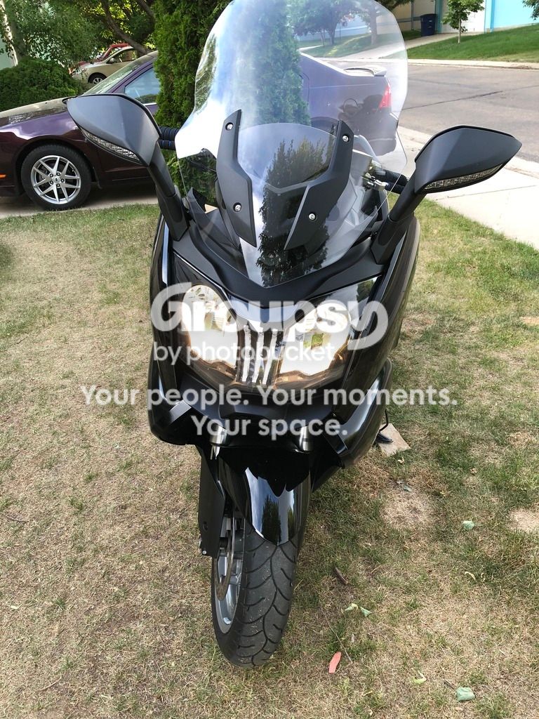

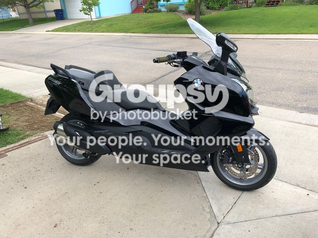

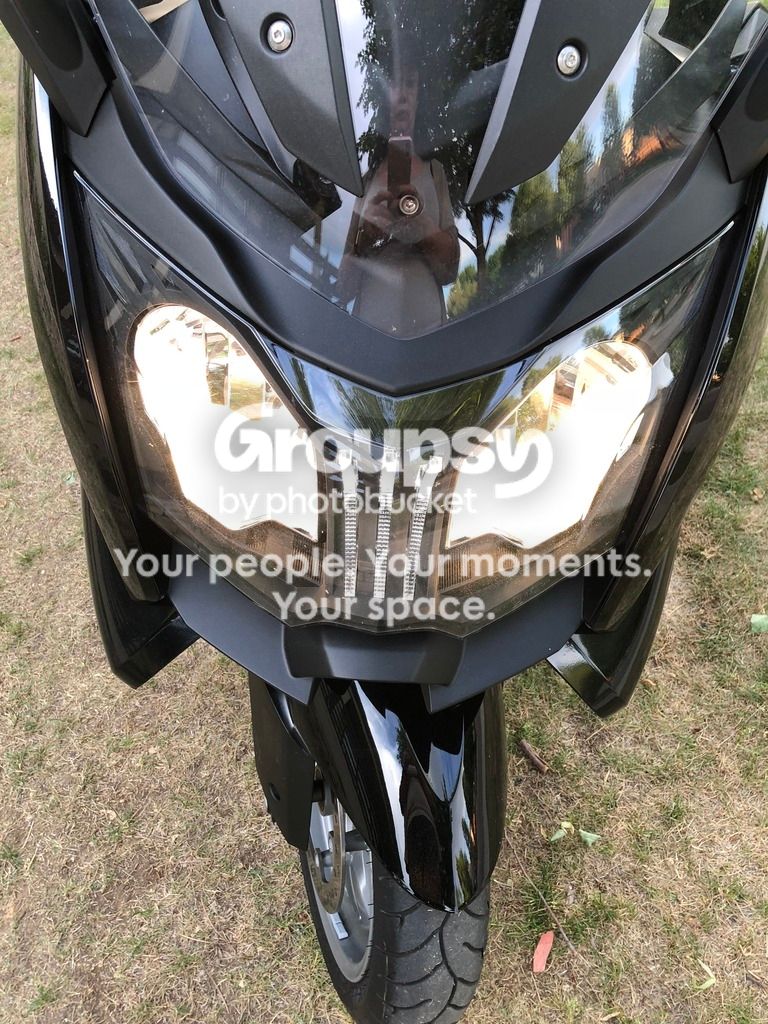

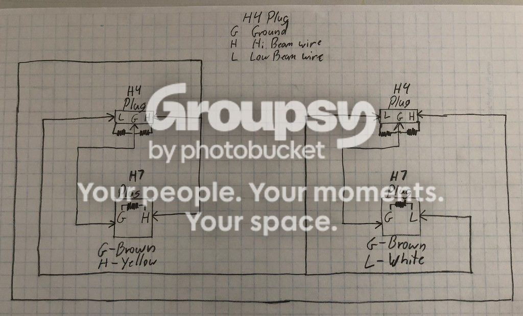

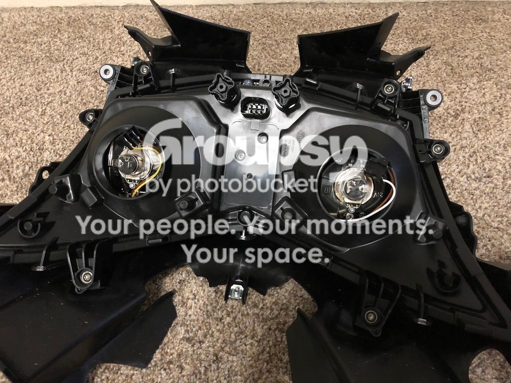

    Has anyone done a dual headlight mod on their C650GT?
    I really want to do this mod because I did it on my Zuma 125 and it worked fantastic. I bought some LED bulbs and light was night and day difference(no pun intended). If you got any ideas please chime in!
