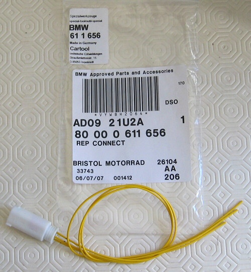

    There is a BMW accessory cable that connects to this plug and it is an unusual one, part number 61128544442 (cost around $20), used for the BMW satnav. Just remove the plug from the other end to connect to your satnav. Pin 1 is ground with brown wire, pin 2 is 12v yellow wire. Pin 3 green & white stripe is also earth. These are switched with the ignition with a delayed start and delayed end. The pins and cable are very small gauge.

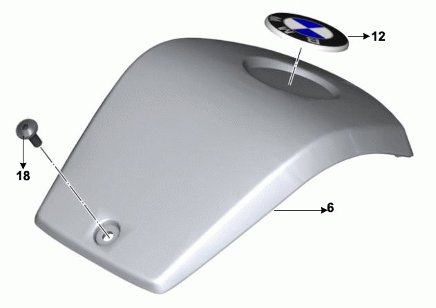

    I don't have a photo of the plug handy, but if you remove the center cover for the handlebars it will be wire tied to the bar underneath. As I recall there is a cap on the plug for protection when not used. You should be able to remove this cover by removing the torx bolt at the back of this cover near the dash. Very easy to get to.

    This is the cover to remove, one bolt

    This is the connector you need to get to use the plug. If you Google BMW Motorcycle Nav or Navigation plug or power plug you can get lots of images and info as this plug seems to be common on BMW motorcycles just different models have plugs in different locations.
