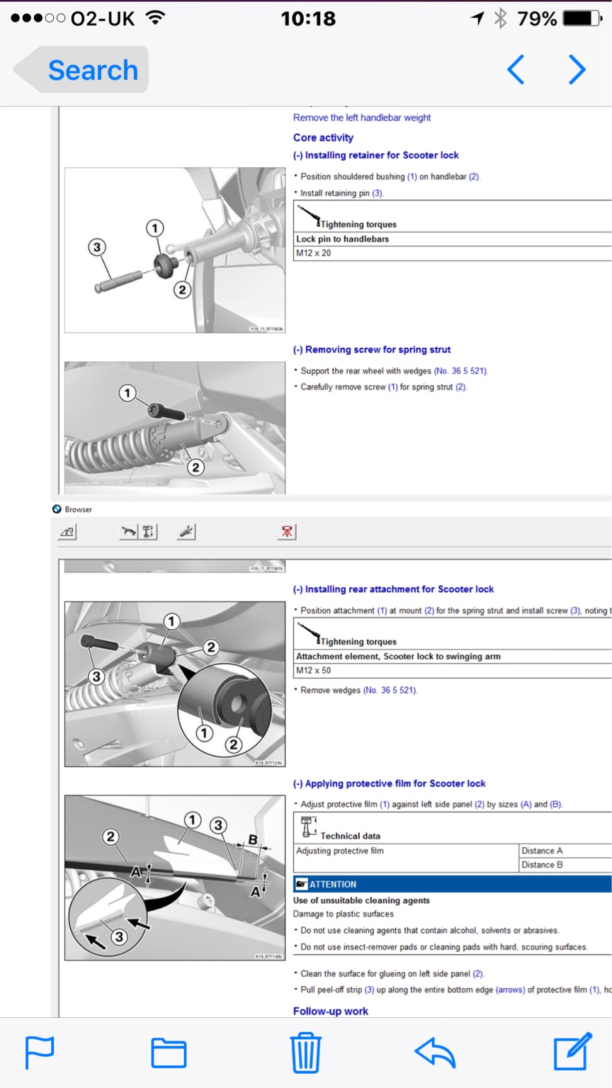

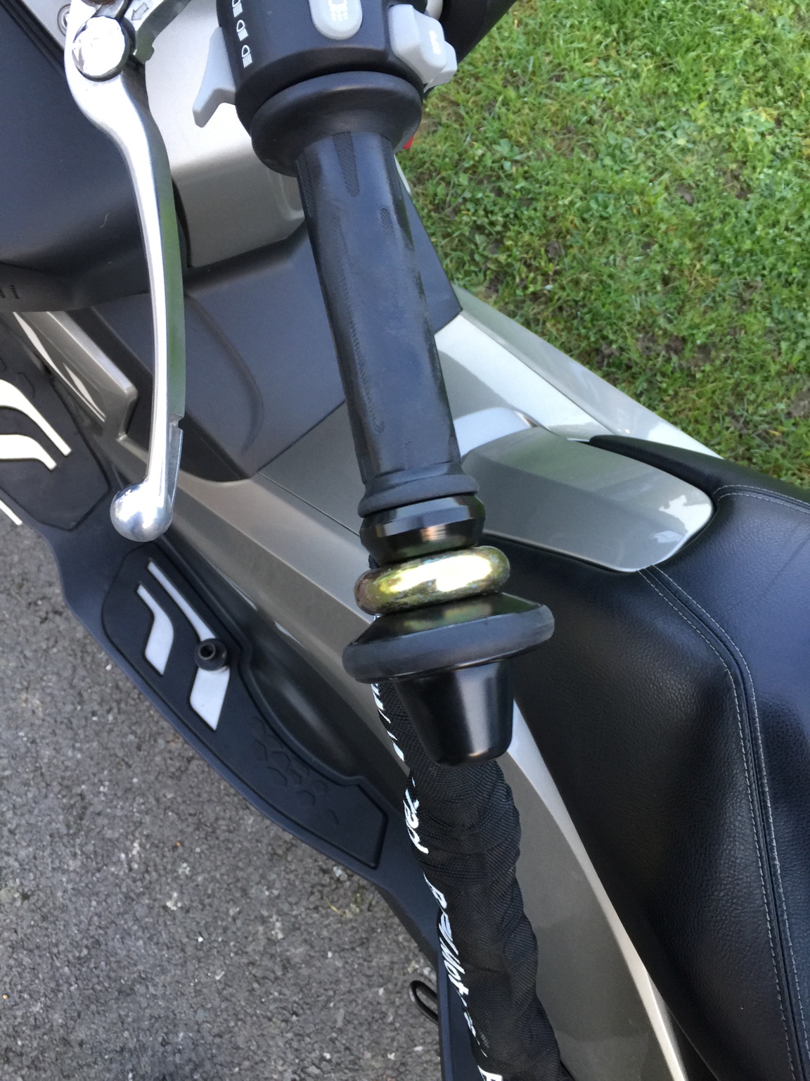

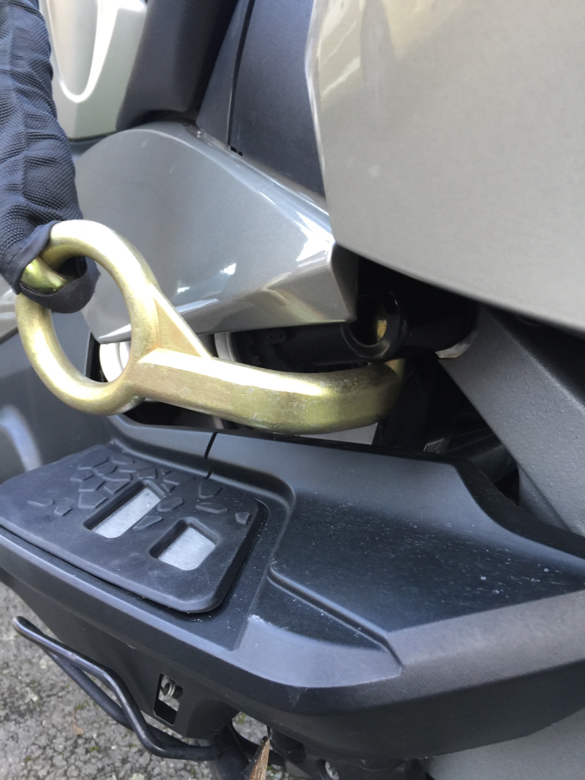

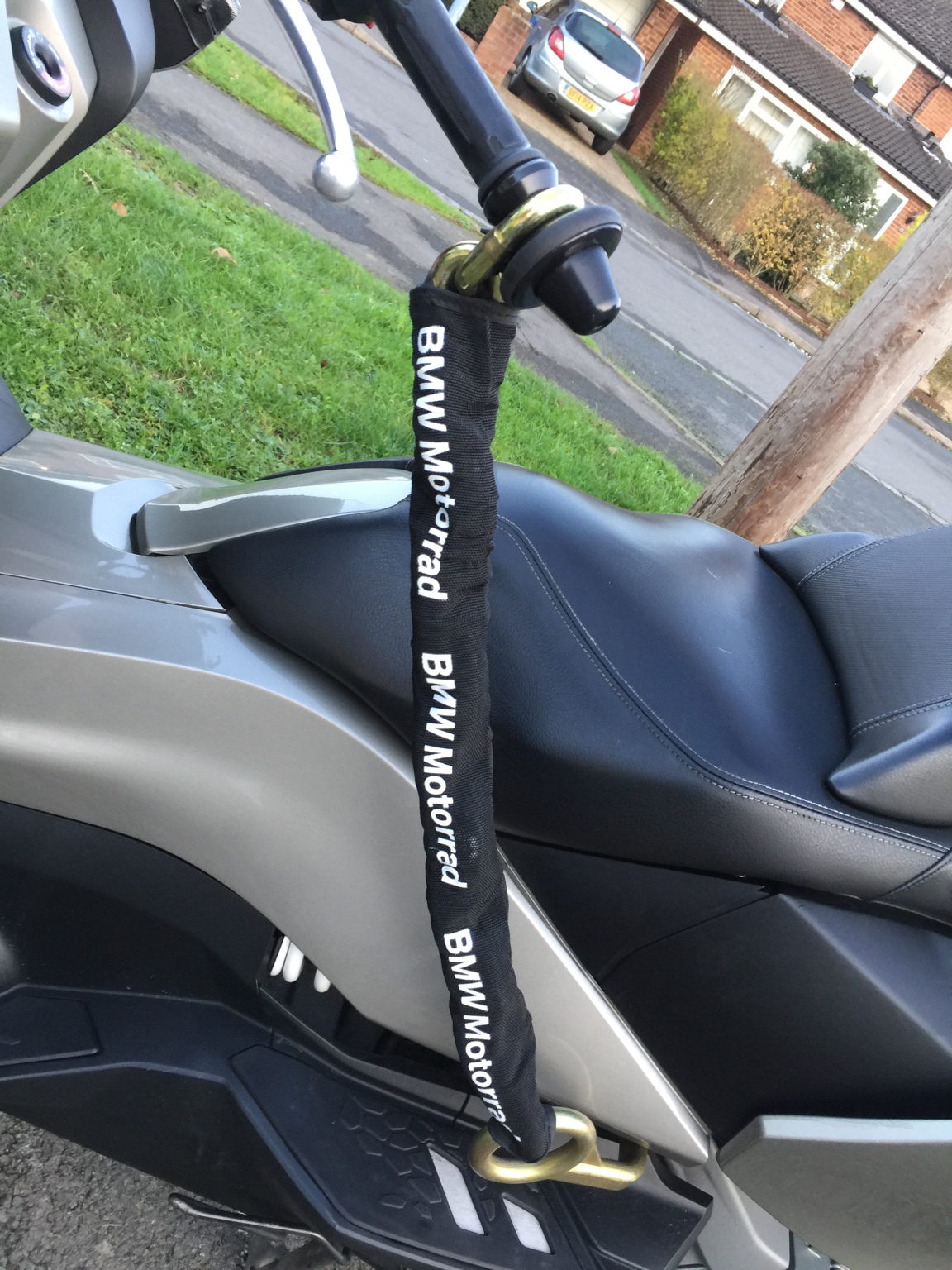

    New chain fitted luckily was brand new on eBay for 57 normally retail 160 +

    What stays on the handle bar end when the lock is not there? BTW - fantastic color bike!

    It's like a pin at the end of bar end they
    Lock together but good thing is once the lock locks onto it it spins so no one can get any leverage to try and take it off

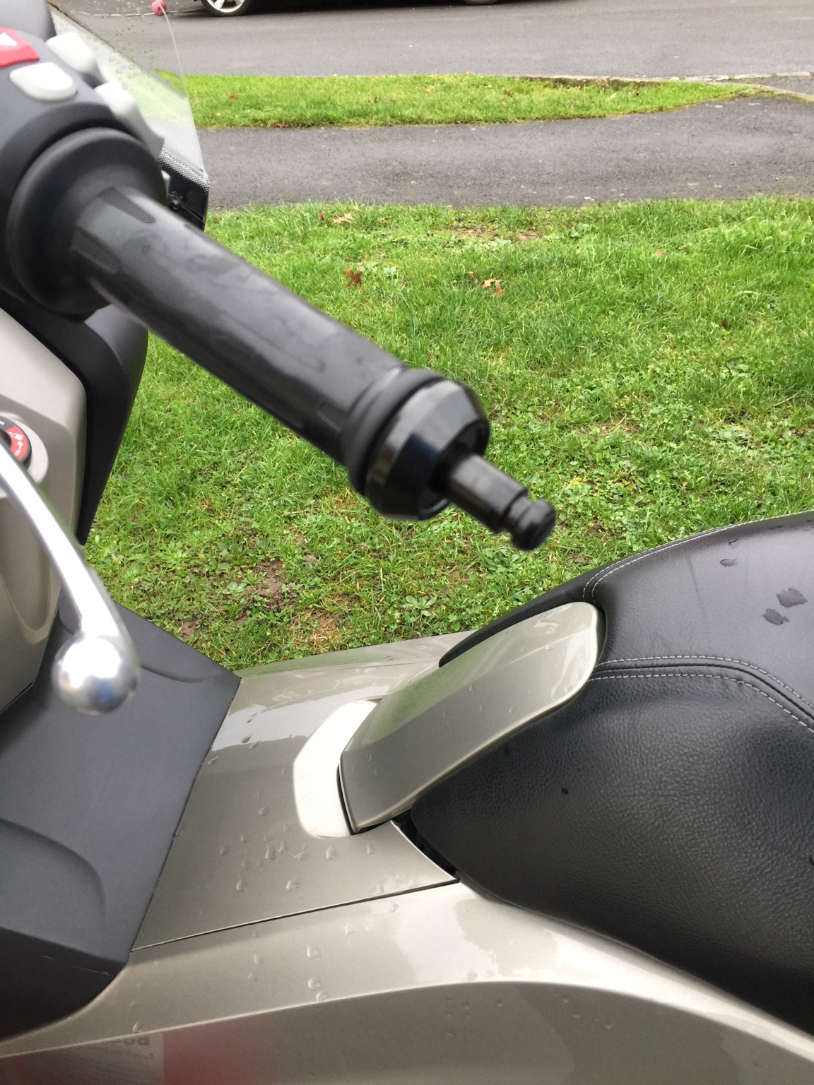

    This is what the bar end looks without the lock fitted not the best looking but hey security comes first

    Thanks for the pic. I wondered whether the bigger metal ring and end cap stayed on. It doesn't look so bad and I'm sure deters opportunistic bad people as it looks quite serious.

    Yeah, I agree and the deal was pretty great. Plus, it looks like you could use the thing as a weapon!
