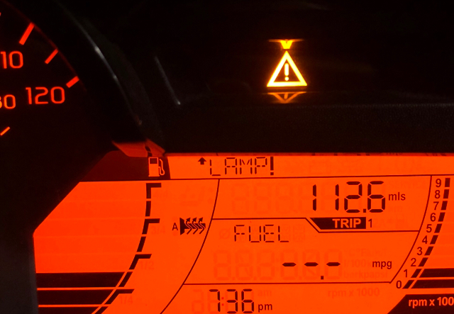

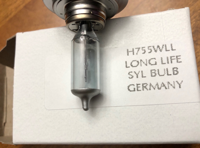

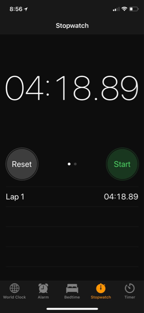

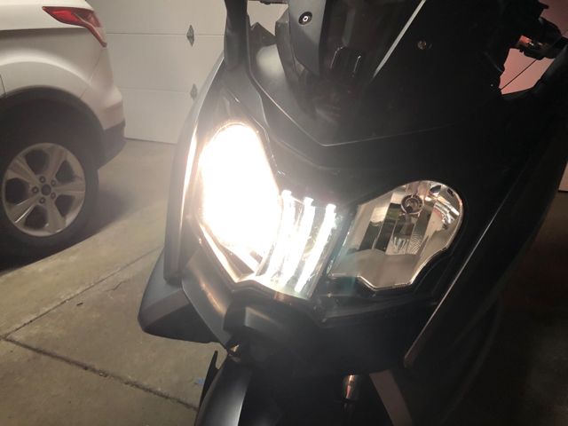

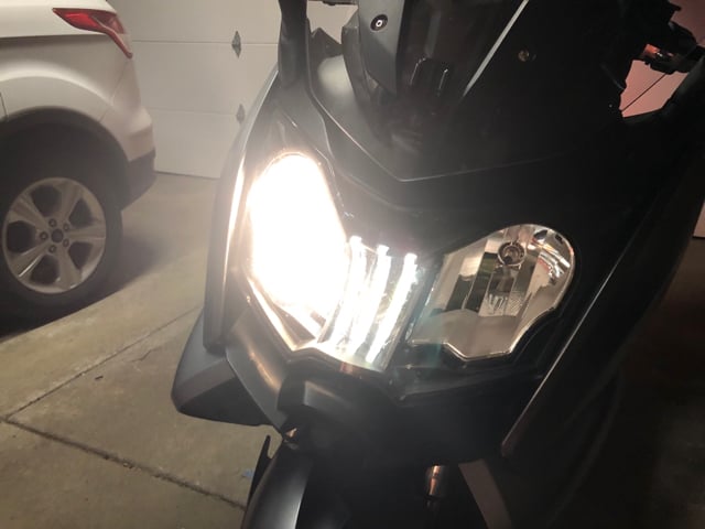

    Well, I put a curse on myself by replying to this thread, tonight, start up to ride home from work...
    Low beam out, same one replaced on trip in September, maybe 3-4K miles ago. It was even an Osram, made in Germany and not some cheap Chinese one.
    Grabbed a new unbranded made in Germany H7 at work. It wasnít dark yet so I just rode home with Aux lights and the LED light on.
    I donít know what BMW charges to replace these, but it took me less than 5 minutes without removing any panels, just reaching up and from behind. Remove rubber cover, unplug bulb, unhook clip by pinching together. Fit new bulb into place and replace clip (this is usually what gives people most trouble) plug bulb back in and replace rubber cover. Be careful not to touch glass on bulb when replacing. I was surprised it went so well, I was figuring about 10-15 minutes.
