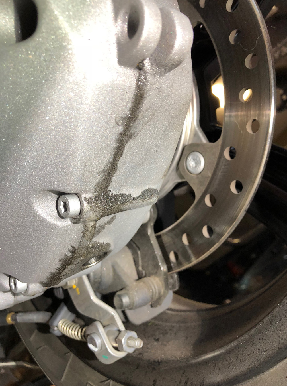

    Just happened to notice after only 300 miles, I have a trace of an oil leak on the chain case. What's the deal?
    Mike
    Jun 2016
    236
    First Id go around and re-torque all the bolts for the chain case cover to the proper torque. I had some similar seepage at 4000 miles and dealer just said they did this to fix it, was normally part of regular service check.
    May need to replace gasket but as I recall yours is new so should be under warranty.
    Jul 2018
    Blairsville Ga
    60
    Thanks - I seemed to remember I seen this before on a thread - I'll check the bolts!
