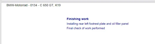

Can't tell you what the C650 GT service manual says because that involves getting out my service DVD and firing up my old PC-with-Windows laptop, which I only use for the BMW DVD, and navigating to the coolant flush section, and I'm not inspired to do that now, sorry.
However, I can tell you I've changed coolant on three GT's, used good old fashioned "pour it in" technique and never had an issue (always use BMW coolant, fwiw).
