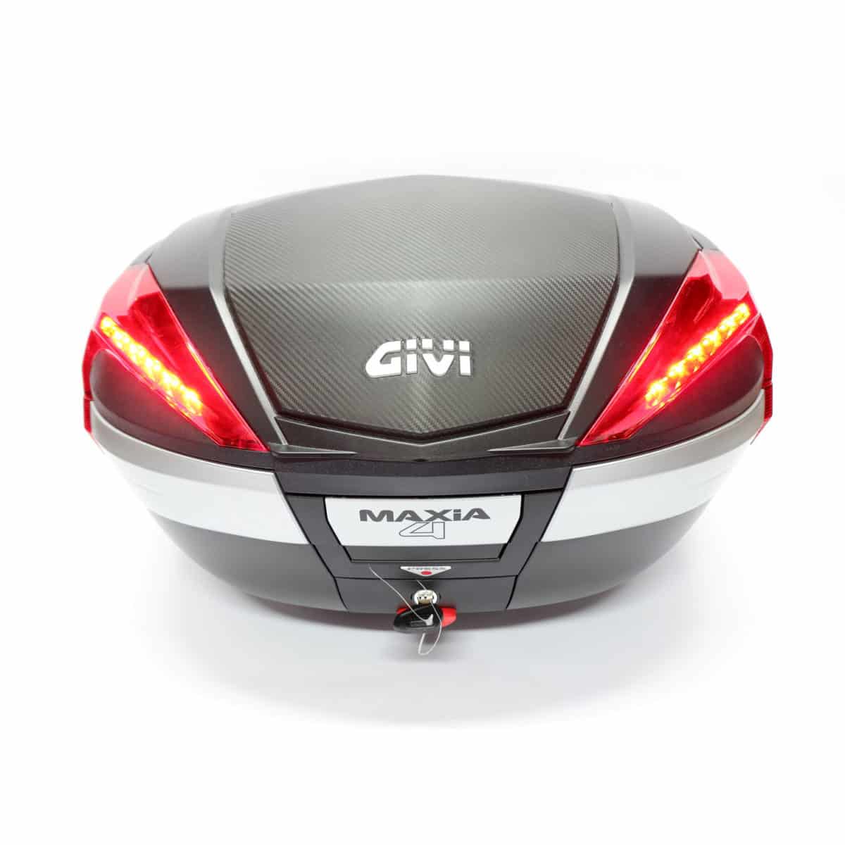

1) You might consider using AdMore lights.
I have helped a friend over the years install some AdMore products -- both a license-plate add-on flasher/turn-signal and lights inside a Givi top case -- and can vouch that AdMore makes very bright, very high-quality products, and has been doing so for a decade or two.
As it turns out, AdMore offers some products specifically for Shad top cases; scroll down to the bottom of this first page of top-case lights:
2) I think that top-case-mounted lights are optimal, because they are at or very near eye level of the typical car driver.

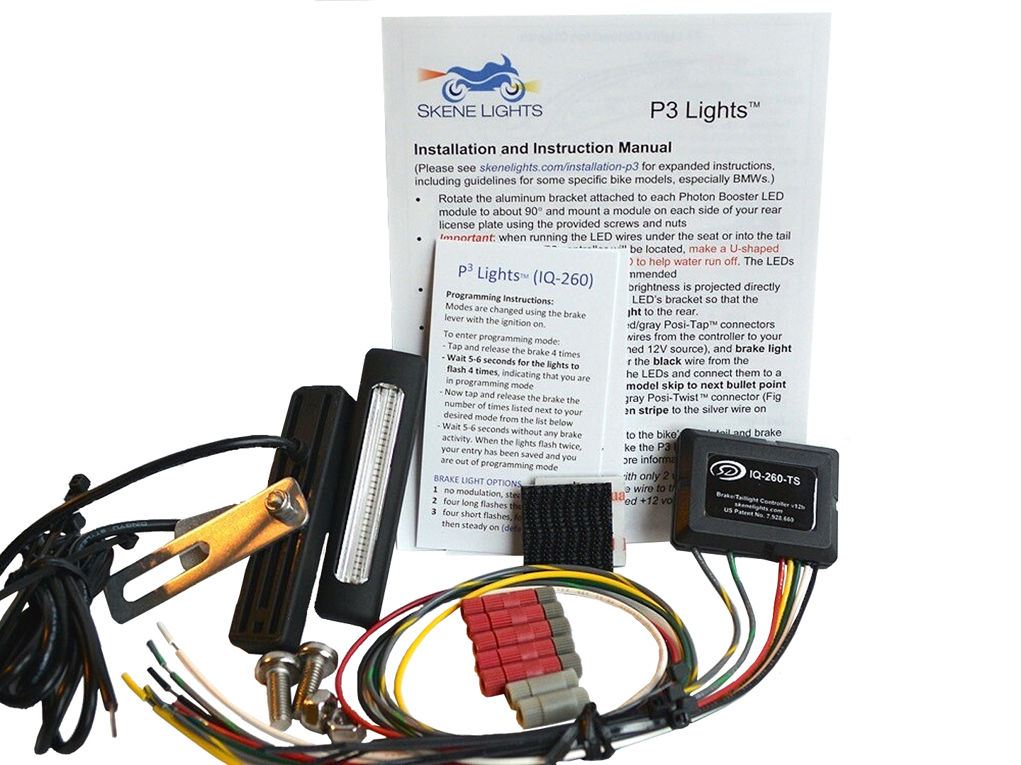

That said, on my C 400 GT I skipped doing any lighting up top, and went with license-plate-area additions of Skene LED brake/running/turn-signals:
I detail that farkle in my gallery, https://billanddot.com/C400GT/#S-38 through https://billanddot.com/C400GT/#S-45 .
I am extremely impressed with the brightness and wide viewing angle of the Skene LED modules (and the software options in the P3-TS control unit). In fact, I have added those same LED modules -- minus the control units -- to the front of my former and current C 400 GTs, as well as the front of my current Royal Enfield Meteor 350.
Like AdMore, Skene has been around for a long time, and has made improvements over the years. It, too, is one of the favorites of the GS and RT crowd in Beemerdom.
