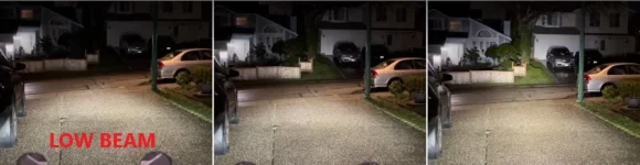

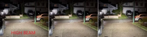

Riding season has started in the Vancouver BC area. A friend and I took advantage of the good weather a couple weeks back and rode the last 70km of a 225km ride on country back roads with little or no street lighting.
I have 2 pairs of Rigid Ignites mounted a few inches above the front axle - spot and floods. The usable light was completely useless in lighting the roadway to travel safely ride at 80kph. I basically rode back into the city using my high beams.
After doing research on the web and talking with friends, I decided to move remove the lights from where I had them above the axle up higher on the C400GT without them looking intrusive & ugly. The only spot I found was the 2 upper corners just below the headlights. I made sure this mount point still allowed oncoming traffic to see the front signal lights.
After countless days of trial and error, I was finally able to find the sweet spot to mount the L bracket and Ignite lights up high into the corners with just enough to allow the front suspension to travel the full 4-1/2" without having to worry about the front fender smacking into the lights.
Unfortunately, I do not have any light pattern photos to share when I had the lights mounted lower. I have the Rigid Ignites spot lights which toggles between high & low simply by turning them on and off.
I have attached a couple of pictures showing the light patterns. The LOW BEAM photo shows the just the low beam only, low beam with Ignite on low and low beam with Ignite on high. The HIGH BEAM photo shows the just the high beam only, high beam with Ignite on low and high beam with Ignite on high. As you can see, there is a substantial amount of usable light on the roadway.

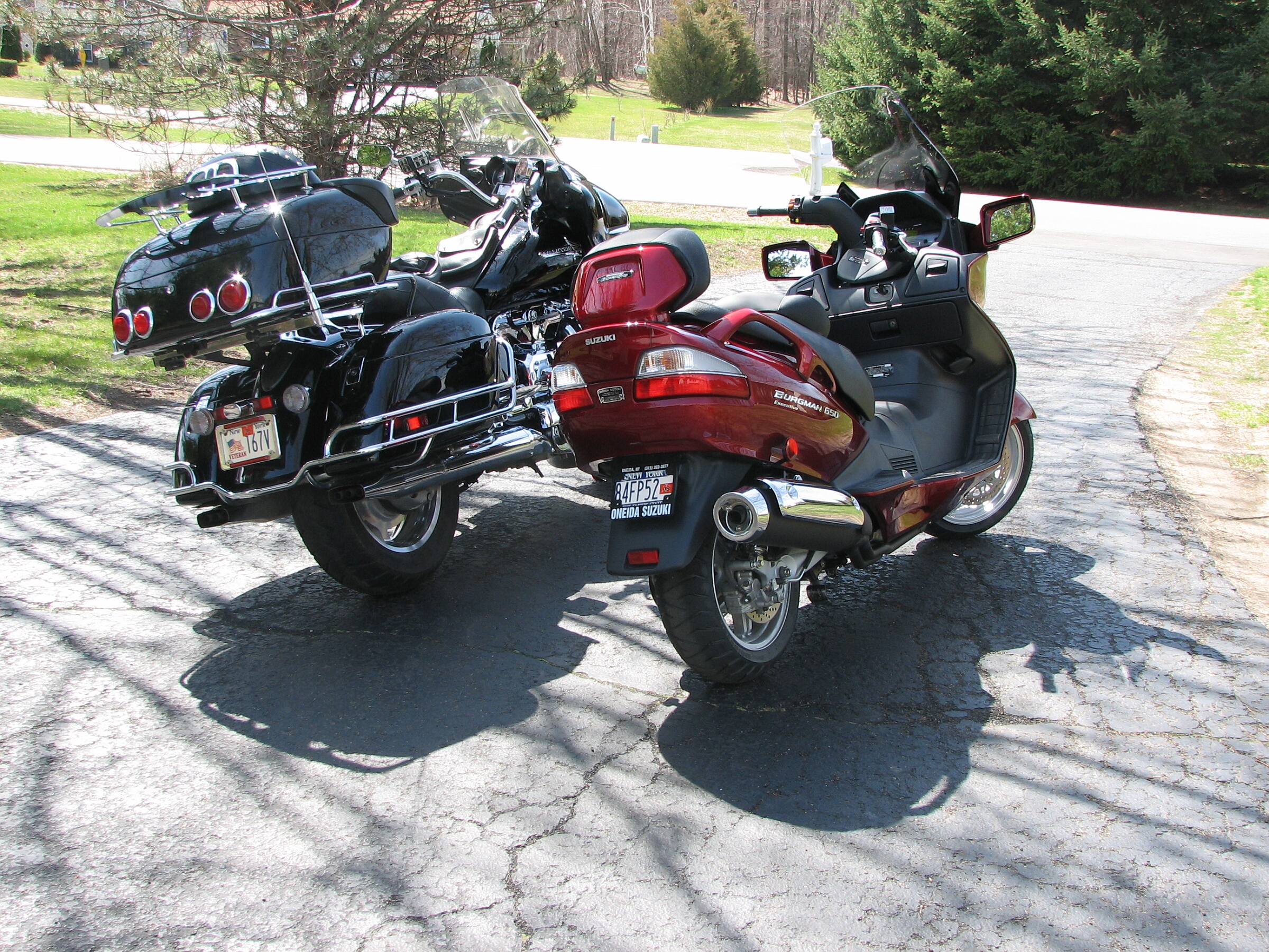

On my two Burgman 650s, I accomplished what I think you're trying to do by replacing the old-school turn-signal single-filament sockets and bulbs with duallies. See this pic/caption and the next couple in my Burgman gallery:
