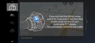

I installed the gps preparation ... and never worked with the multicontroller :(
I send some emails to Bmw asking for thelp
I have one Bmw c400gt 2023
I just bought the Gps preparations cradle
, and the Connected Cradle as well .
I just make the connection process between the APP and the Connected cradle .
And never show option to control the app with the Multi-Controller.
Attached you can see some pictures with the software version and my vehicle screen .
I just read in some forum , that
BMW would need to apply the Nav Prep coding to your TFT cluster to enable it.
Is this correct ?
If you need more information please let me know.
Thanks for your help

We would ask you to plug a BMW Motorrad Navigator 6 into the holder of the navigation preparation (e.g. test device from your BMW Motorrad dealer) and operate it there for a few minutes. This will update the LIN connection, which in many cases has led to the elimination of the mentioned problem.

Thanks for your help, I am very disappointed
On my visit for the first service of the Scooter (October 5th) I showed them this email and asked if they could help me and do it, the response was positive, but it seems that they do not have any Navigator in the service department and they told me that I should Wait for the spare parts department manager. (Mike Miliam) will return from a trip.
Today I stop by again to try, and after an hour of waiting, they refuse to do it, they ask me for the invoice for the cradle ,where it was bought, to open a case with BMW.
I don't know if this is the right way to fix it, or the one that will piss me off and force me to return the cradle . But it's surely not the way to try to help me solve my problem.
I think I'll have to buy a Navigator 6, try it out myself, and then return it.
For me it's not the right way to do it, but it seems like this is the easiest way..

Yes, I did have the BMW ConnectedRide cradle which I ordered from Germany. Like every else who has ordered the ConnectedRide cradle......the support from BMW Motorrad is less than stellar! I spent a month exchanging emails with both Jorg and Steffan. Email exchanges took days and often upward to a week for them to respond.
I started with Jorg then went to Steffan. Each time there was a support person change, discussions would reset to square 1. I found they definitely DO NOT know anything about the ConnectedRide cradle other than the fact what's on their story boards they use. IMO, I would've probably received better quality support calling up a Yamaha or Harley Davidson motorcycle support team.....at least they have a legit excuse not to know but not the BMW Motorrad Connected team.
As part of the troubleshooting, I've gone as far as sending them short videos showing them the problem. I can definitely say they still weren't able to understand the issue.
I tested using an iPhone and Motorola play with both having the same results. I issue I tried to overcome with the MENU button on the pod. This button is suppose to move the GPS screen on the bikes TFT up to the smart phone paired with the ConnectedCradle. Just did not happen. I also contacted my local BMW dealership to ask if software had to be updated which it did not. The term LIN was tossed about in many conversations but no one at BMW Connected was able to explain.
This fiasco went on for a month. I eventually returned the cradle back to BMW Motorrad Bohling in Germany at great expense.............cost me $100 is duties in taxes foe the import and another $75 to ship back from Canada.
I like my setup now using the Wunderlich cradle and Motorola smart phone. It would've been great to have the added functionality such as zooming in on the maps riding thru twisties. At this point, I am not willing to buy another one to test but willing to buy if someone is able to figure out how to get it to work.
