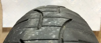

@Rootctrl - I'm curious, do you even see the wear bars any longer?
Here's what it looks like on the Maxxis Supermaxx:
Once that bar is in contact with the road, the tire is done for and would fail safety inspection. Local requirements generally require a minimum of 1.6mm or 2/32" of tread depth (typically measured toward the inside of the wear bar, I believe), or if the tire has met its manufacturer-defined limit - the wear bar.
