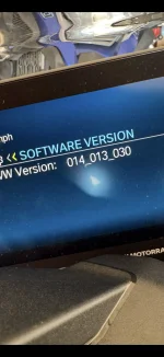

My CE04 finally went back to BMW as it was a lemon. It kept cutting out and I had constant red screens appearing so I was finally fed up with it and got rid of it. That’s the bad news. The good news is I now have a 2025 model with an SOS button (which the other one did not have) and a touring screen. So far, I have travelled 100 miles. Fingers crossed that this one will not let me down. It will charge at whatever I set it at, and does not change. I have not looked yet to see what software version it has.
