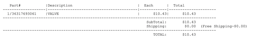

Interestingly, I just ordered a stem as well to monkey around with. I'm going to see if I can machine about 0.5mm to 0.75mm off the back side on my lathe. This should help add some clearance for the valve stem mounted TPMS sensor for the front wheel. Ordered on the weekend and should arrive mid week.
I'm hoping I can take back to local BMW dealership to install for me. Definitely keep you posted.

I am curious if our wheels are threaded for the BMW RDC's.
I did reach out to Phad on Facebook a month or so back. You need to add another module to the C400 by 'frankensteining' in as there is no feature/option connector. The module in Canada is about $450...definitely less in the USA.
I'm pretty comfortable with the bikes electrical but hesitant to 'frankenstein' it in. Once added, I'm quite sure you can use MOTOSCAN to enable the option.
Yeah, @mzflorida explained it to me a week or so ago, via an email, re the frankensteining. That is something I probably wouldn't be interested in, especially already having one C 400 GT replaced by BMW last year -- I wouldn't want to give corporate an excuse to not honor my new warranty. That's why I asked in my YT comment whether Phad knew whether a dealership could do all this, which would of course maintain the warranty.
I still don't really grasp why a dealership couldn't do this, if the sensors are a BMW part, and they certainly have the equipment to talk to and update the bike's software. Is it as simple as they have not officially provided for this as an option -- just didn't think about, or something like that -- even though it can technically be performed?
And, yeah, I wonder how the sensors would get mounted (which is also something I alluded to in my YT comment). If there is provision for mounting BMW's (or anyone's) "RDC" built inside of the rims, then wouldn't it seem as if BMW DID think about the option? I mean, why else would they do that kind of extra machining of the wheels? As far as I know, no other bike in their line-up uses those wheels. The whole thing is very weird.
And as I've ranted before, this whole issue is one of my two major gripes about the bike, i.e., not having made TPMS either stock or an option, as they do on almost all of their other bikes. (The other major gripe I have is the lack of cruise control, given the moniker of Grand Tourer, and especially given that the bike has throttle-by-wire, i.e., no need to have servos controlling physical cables -- the whole thing could be done with software.)
