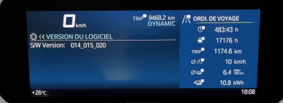

Good morning everyones, yesterday was my 2 years or 10.000km maintenance, they change the brakes fluids and my rear break pads.
Also they did an update of the OS (they received in March a new version) and it did fix the problem for the turn signal automatic turn off stay on and the charging is fine too. I charge last night and everything when ok before my charging would stop for no reason.
So if you have this problem go to your dealers and ask for the update and this should be NO CHARGE! since you are still under warranty.
Here is the new version number.
