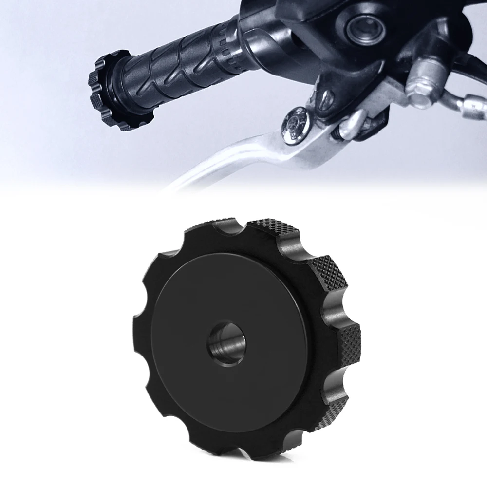

I don’t use a throttle lock much so I can’t justify paying a lot of money for one. After careful thinking, I decided to pick one up from AliExpress.
This is the one I bought, but I paid considerably less during a promotional sale last year.
I just found this on AliExpress: C$35.89 | Motorcycle Stabilizer Throttle Lock Cruise Control For BMW CE 04 2021-2024 C 400 GT 2018-2024 C 400 X 2018-2021 Assist End Bar
