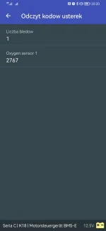

I also have stalling issue in my 2013 C600 sport. I get code 2767 Oxygen Sensor 1. I replaced intake hoses, checked all other and everything seems to look fine. I cannot find any info about this code, but probably about mixture too lean.

Did you try replacing the oxygen sensor, or at least checking the connection/wiring to it?
I did check the wiring and its ok. The funny thing is that the problem is gone so far as I have used 98 petrol. I do not believe it was caused by petrol so I left the bike in workshop today
If the error comes back I would look at replacing the O2 sensor, its proper functioning is very important to the engine's functioning. Once a year running a good injector cleaner through the system is also a good idea, in general.
