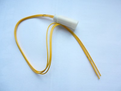

Hi buddy. No , I’m not talking about the power supply in the glove box ( I use that for charging my phone) I spoke to BMW and they said there should be another power supply somewhere under the handlebars or fairing , but he wasn’t sure exactly where ? If I can locate it , he said I would need an adaptor ( white plug with three wires ) called a repair plug. That would then connect to the Zumo XT lead & plug into that power supply.

Please refer to the attached photo for connecter. BMW Motorrad also sells the end which fits into connector.

It's 12V switched from the ignition, well it is on my C650 Sport anyway so would assume the same for most models

1) I found a few of them, but they all seem to come from this one seller in Germany, WhileLightsForBikes: https://www.ebay.com/str/whitelightsledlightsforbikes
2) So there are positive and ground wires, and a third wire you just ignore, correct?
When things warm up (outside and in my garage) in the spring, I'll take the handlebar covers off my '22 C 400 GT -- something I've done once before, when doing some through-the-dash farkling -- and look for the matching OEM plug. I didn't notice it before, but I wasn't looking for anything, either. Then, assuming I find it, and assuming that that plug I just ordered matches up, I'll put a voltmeter on the wires of that ebay plug and confirm what's going on.
If all of this checks out, I plan to use this to power some Skene fender-bolt-mounted LEDs, the conspicuity kind, not driving lights (I haven't ridden at night in years) that I bought a couple of months ago: https://skenelights.com/photon-booster-led-modules-pair.html
Thanks again for pointing out the proper plug.
Hi, yea just ignore the 3rd. It's a control wire when a beemer sat nav is fitted.

In the meantime, as I indicated a couple of posts ago, I bought that adapter, found the unused stock plug, have started the work, and have this documentation to add, if anyone comes across this thread in the future.
Here's another pic of the unused stock female plug, which is cable-tied to the rear brake line underneath the handlebar cover:
And here's a pic of the back side of the male aftermarket sat nav adapter (which I double-loop-cable-tied in the same spot), connected to the stock plug, and with some annotation that I added:
The red arrow denotes the ignition-on battery-voltage lead, i.e. the hot side; the black arrow shows the ground wire; and the yellow arrow shows the wire to be ignored if you're just looking for a standard power source (that to-be-ignored yellow-arrowed wire, if you're curious, is actually an ignition-on c. 8V source, according to my measurement, presumably used for some function by an actual OEM sat nav).
One last note: that red-designated wire stays hot for 60 seconds after the ignition is turned off -- I timed it -- if that matters to anyone looking for a standard power source (as opposed to the headlights on my '22 C 400 GT, which stay on for about eight seconds after power off).

BMW also sells the cable for $20CDN
83300413585 REPAIR CONNECTOR-3 POLE

Bought this one
and it worked perfectly.

Bought this one
That one worked fine for me as well. One nice surprise, at least in my package, were two cross bars; one was 12mm and the other was 22mm. I wound up using the smaller one because I thought it looked better and also because I already had a Zumo XT mount for 12mm bars. I also had, from a previous BMW bike, the BMW repair plug which conveniently plugged into the existing connector under the handlebar cover. This all makes for a very neat installation.
