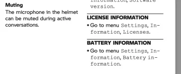

It's weird I don't see the info, in the menu where do you get this info? I've look and scroll up and down and I don't see it.
I don't think this is on the manual. It's a feature added in the latest SW update. So I don't expect it to be mentioned in the manual quite yet.
I stand corrected. In any case I don't remember seeing battery health info there before. But I also wasn't looking. I am now curious what people with older versions see there.
