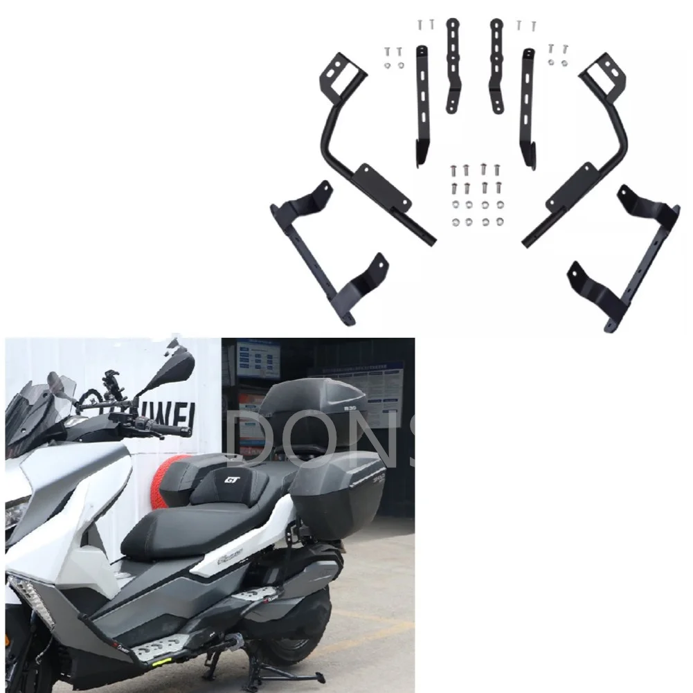

side cases available?
1) Nice find! I had looked at AliExpress myself yesterday, but didn't see any.
2) I hope they work, as they're fairly expensive: $69.30 + $109.12 shipping = $178.42.
3) I have the same (apparently unanswered) question that appears twice on that page: "How doesn’t [sic] the lower support connect to the passenger footrest?" I think the intent was "How does ...".
Nevertheless, as at least part of the bracketry connects under the grab rails -- which have very large bolts -- it's probably solid enough.

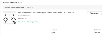

Does anyone have an update of attempting the side mounts from AliExpress? I am tempted to buy them, but would really love to hear about quality & fit first
Steve,
Member @badactual1 just posted his finding side-case mounting brackets earlier today, and said he just ordered them. And since it doesn't appear that anyone else had reported finding such mounts for a C 400, it looks as if we'll all just have to wait for his report after the brackets arrive (which might be two or three weeks from now), and he's had a chance to buy hard saddlebags and get everything mounted on the bike.
I'm halfway tempted to get them myself, as the brackets and the picture in the ad, with the Shad cases in place, look pretty nicely designed. And the overall cost -- brackets and cases -- seems reasonable.

1) Certainly looks like you're going to be the guinea pig on adding hard bags to a C 400.
And also looks like there is definite interest from some folks awaiting reports of the quality and your progress.

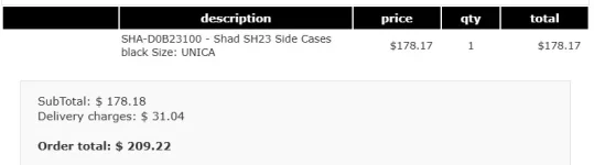

Just ordered the SH23's (Black) from Motostorm, shipped to HI for 209.22

Ok unpacked - First impressions.
Box damaged a bit - not a big deal. sufficiently wrapped in cellophane. would have been better to have them cast in expanding packing foam; Their method got the job done.
Steel is thick and will definitely hold side cases with no bending issues. Isn't powder coated, which is fine - If I need to make changes, i'll hit it with a can of rustoleum if I bend it a little for fitment. I live right on the ocean, and everything rusts quickly, so I'll be hitting it on the inside regardless. The welds are adequate and will definitely hold a case, and 23L of content.
Surprisingly, the paint does not smell highly carcinogenic. The "L" shaped angles are symmetrical, the two base pieces are not, and seem to be congruent with the attachment points. because of the thickness, I am already worried that I might have to grind a couple notched out of each side of the OEM BMW frame for the top case. I should have taken more pictures but wanted to get you all something to look at. More to come.
