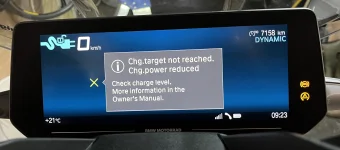

Hi everyone's a week ago I got my front tire change I got a Michelin Pilot road 4, wow what a difference with the Maxxis. Anyway while I was at the dealer I've got the Os update on the scooter, after multiple crash it look like it was working ( I've got the 1200 RT display syndrome that what the dealer toll me they had a similar problem)meaning now any setup I put on in the menu it reset itself about a hour or so.Now the 6 amp set up to recharge doesn't work no more so when I charge I need to set it at 8 or 10 amp but the problem is that it reset itself and goes back to the 6 amp basic charge but it doesn't work so it stop charging the scooter. I was wondering if anyone had this problem?

Hello everyone me again to give you a feed back, I left my CE04 at the dealer while I was gone on vacation for the software problem.
After 3 weeks nothing done and the answer from BMW Germany is it will be fix next update next year!
So if you go to your dealer for something do not get the update right now.
So my scooter work but it doesn't keep my preferences on the long run maybe a few hours and it stop willing to charge at 6 amp.

Had a new error showing this morning. SOS mode not available contact dealer if this happens again.
Right oh. Continued and then recharged at my work 3 phase charger x3 @10amp. Washed the bike and at next start up error message was gone, must have been a data connection error. Went out for a flat out run to hell with environment :ROFLMAO:
Left with 60 miles range, did 31 miles worth of Dynamic riding and had 10 miles remaining on return. #Plenty. Now on the house 3 pin charger @10amp.
