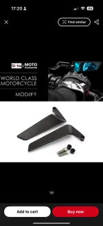

Also I have just ordered these, hopefully they fit ok, I think they suit the bike better.

Certainly will. The first thing I thought when I seen the bike, such a futuristic looking machine, really concept in design but just plain mirrors fitted? Odd but hey, I’ll post pics when I’ve fitted them, should be next week 👍🏼
