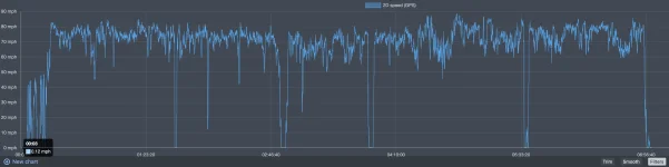

==> Last, moving along to my '23 C 400 GT, on my trip to from NY to NC last summer, I also got 89. This was with about 1,500 - 2,000 miles on the new bike, but was NOT part of an actual top-speed test. Instead, 89 was just part of a spirited riding day, often in the left lane of some Interstate highways with 70 mph limits. Here's a paragraph I've posted before on the five days of that trip (two down, one day of goofing-off riding, and two days back):
Day 1: -30.2, 26.6, 89.0
Day 2: -38.1, 35.9, 86.5
Day 3: -37.2, 39.0, 86.4
Day 7: -25.2, 23.4, 87.1
Day 8: -17.8, 28.1, 86.3
And here's a speed graph of that first day:
So I'm NOT surprised that you haven't seen a real speed of 90, but I AM surprised that you haven't seen a real 89 (which would be a display of about 93) ... unless, as I say, you don't have a lot of miles on the bike (or a nice long level stretch to leave the throttle pinned for a while).
Note that I weigh about 215 myself (plus gear, plus top case -- then a BMW, now a Shad). And I'm about 5'8", 29" inseam; taller folks would likely present a more air-resistant torso. Also, on all of these runs I've had the Wunderlich "Marathon" windscreen in place. The Wunderlich is about the same height as the stock shield, but is wider -- I would have expected it to have greater air resistance, but maybe I'm wrong, and it actually has less resistance.
