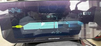

This reminds me. As an experiment I plugged the CE04 into our mahoosive 2kw battery pack and it added around 8 miles before giving up the valiant fight! Stupid really in terms of loses, but good to know it would do the job in an emergency. It initially produced an charging error on the bike, but when I insisted it was fine really, it then exhausted the battery pack fully FWIW. Fair play to VTOMAN. :cool:

Obviously. It is far too large and far too heavy to be carried on the skoot, but could be deployed in a Thunderbird 2 type way should I run out of battery a mile or 8 from home. FAB Virgil.

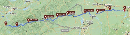

I took a second refreshed look at this idea this week, as I'm planning a 1600 km (1000 mi) trip with the BMW CE04, with most of those miles being in remote locations in Western North Carolina. I expect the Jackery 1000 battery to charge a BMW CE04 an additional 10% in about 45 minutes at 8A/110V. That's slow enough to be useful only in emergency situations. but I've also had to roll into a charger station at 1% before when the closest charger to me was full of abandoned EVs.
Of course, carrying an extra 20 lbs of gear impacts the range.
I contacted "The EV Doctor" for advice, and he hinted that the best direction might be to buy a cheap J1772 EVSE that works with two-prong outlets, as they lack a ground. I did some research and found some cheap options that might fit the bill:
- Southking SK-EV16
- Honda Clarity cable
- Toyota Prius cable
I also found a cheap ($90 with coupon) Sankaba J1772 charger on Amazon that allows ground monitoring to be disabled on the fly, which is exactly what I wanted. I'll let you know how it works!

I had a look at your post about the long distance trip, wow!, and, Great!
I look forward to returning to my intercity touring, but just taking days to do it instead of 1,000 km in one day type of touring.
