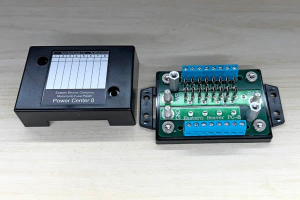

But I will need to add a relay or a PDU of some sort. I'm leaning toward Eastern Beaver's PC-8; I've used two of those, on prior bikes, and consider it a good quality unit:
