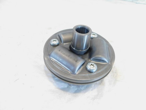

Good evening,
A few months ago, you mentioned the torsion damper on the drive shaft.
There's very little chance of this becoming defective and causing the vibrations you're talking about. This is because the speed of rotation of the torsion damper is linked to engine speed, not vehicle speed.
What's more, the vibration damper is a simple mechanical part, not subject to wear. It is very difficult to break. It is not a consumable part in an engine.
A very simple way of checking that it doesn't cause abnormal vibrations is to remove the complete drive and belt (and therefore the clutch too), then start the engine. In this way, you can check that the drive shaft does not vibrate at different engine speeds. This is also a great help in understanding and identifying engine noises from transmission noises.
