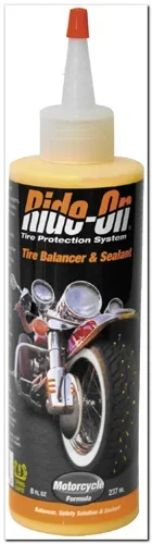

try installing "Ride On". it balances the wheels incredibly well without the need for external weights. It's the only thing my local dealer uses, and it seals punctures anf nail holes. Even sealed up an 8mm BOLT that I picked up in my rear tire and got me home safely!
http://www.ride-on.com/
Ya just pump it into the tire ay?
