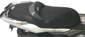

Has anyone installed the Wind Rider Seat Cover to their C400GT? If so, did you have to remove the seat completely? If you did, did you remove hinge from seat, install cover then put hinge back on? I know you have to remove back rest but that looks easy enough.
I just bought one and so far cannot get it on the bike. I am not prepared to dismantle the seat to confirm my suspicions about it. To fit it you have to pull it on so that it completely wraps round underneath the edge. I don't see how you can do this and still have a hinge in place. Further more, the material will block your lock mechanism so the seat will not lock down. Finally, the two velcro straps are going to get in the way of your luggage carrying abilities. The seat goes on over the bum stop so far as I can see and is very stretchy so it conforms to the shape of the saddle. It will work fine with a conventional motorbike saddle but I don't think it will work on a scooter. I am in corespondence with Windrider so I may have a more positve update at a later point....

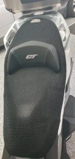

What a faff! It is supposed to be made for the bike but no, you have to modify one from their stock supply. Not prepared to do that but I do not suppose they will offer a refund. We will see. As a side note, there is a fitment size tag inside the cover which in my mind is proof it is a generic seat cover.

Just got one for c400x fits but will not lock due to covers thickness preventing the components from meeting
I have pictures etc to them and suspect a return refund , not suitable for a hinged locking seat.
