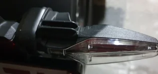

Hi @alexw146 Thanks for sharing the photos, I bought my CE04 in January 26 in France, where I live. The rear indicators have a plastic guard, not that it helped, my son was getting on the back and snapped the left indicator :-( I attached two photos that include the (ineffective) plastic guard, do you think the Wundelich guard will still work with the plastic guard, did you have this part also, if I buy the metal guards maybe I should remove the plastic ones when I change the indicator...? Thanks mate.

Hi! I would say that you would remove the plastic guards or any other after market protection THEN fit these guards.
I was concerned that the light would be covered too much by the fitting but that's not the case. The light is just as visible to other road users.
What I like is that the metal is strong, definitely not flimsy. It might sound odd but every other protection is close fitting to the lights where as the Wunderlich guard sits away from the light so there is no contact at all from legs, bags etc.
Some people will prefer the minimalist look of the close fitting guards where as I think it suits the aesthetic of the CE04 having the ones I've fitted.
For a replacement, look for a S1000R indicator, they're essentially the same (much cheaper, too) but with a shorter cable. Meaning you'll only have to dismantle the indicator housing instead of half the scooter and can then solder on the new indicator cable onto the leads that are already there.
