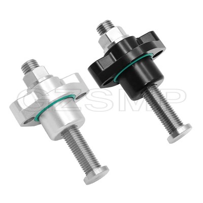

Best, and cheapest solution will be to modify your tensioner into a mechanical one that does not require the spring-loaded mechanism to operate. Then, once per oil change, remove the side panel and re-check the tension of the mechanism to ensure the chain doesn't loosen. Consider it just another step for the 6,000 mile service interval. The 'hydraulic' tensioners are a much later addition to the engine, and the pieces cost about $500 total. The unfortunate thing about any tensioner that comes from BMW on this engine is that they all move constantly in some way or another, so they can fail as they move. It would be better to make a tensioner that does not free-float or move, and have a maintenance item at the 6000 mile servies to adjust the tensioner using a certain procedure. Unfortunately BMW is very proud of their designs and mechanical engineering expertise, and just refuse to see the problem and have every excuse lined up just in case.
The way I modified mine was to disassemble it, take a 6mm bolt and modify the head to a blade shape with minimal height so it did not tolerance stack the actual winding mechanism, that would mate with the slot in the top of the spiral tensioner. Grind away the last 6-8mm of threads right below the head of the modified bolt, so that it spins freely in the housing when inserted from the bottom, and make sure it does not bind. Then insert it, add a nut to the top, grind a slot in the end for a small screwdriver so you can set tension with it, and add the internals making sure that the spiral extender mechanism mates with the blade on the modified bolt head. After that, wind the mechanism tight, using the newly installed pieces and lock the lock nut, to keep it from spinning and expanding, then install in the engine. Unlock the lock nut and the spring winder will extend the tensioner to the proper length. You can set a preload with the slotted end, a few times then let it relax and find it's own place. Once it's set, tighten the lock nut and you are done. Every 6K miles loosen the lock nut, rotate the mechanism about a turn out, then in, to reset the pre load, and retighten the lock nut.
You'll never have a failure if you make it a mechanically set and locked unit, and it only takes about 2-3 hours to modify the stock unit.
Thanks guys for the input. I replaced a cam chain tensioner on my old Kawasaki Vulcan that probably took me 10 mins. I was a spring load type. This manual adjust type is interesting. I'd probably go with the Ebay one. How would you know when you have it set properly? Not too tight or too loose?
