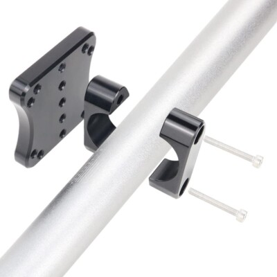

I bought that same bracket on Amazon -- https://www.amazon.com/Motorcycle-Navigation-Bracket-Mounting-2019-2021/dp/B08Y56V5LR -- on June 14, 2022 (less than a week after I took delivery of my then brand new C 400 GT). So, great minds think alike.
However, I returned mine a few days after it arrived. My problem was that that bracket did not fit my setup, which was the Wunderlich Marthon windshield with vent: https://www.wunderlichamerica.com/b...hon-windscreen-clear-tinted-solid-tinted.html . My memory is a little hazy a year later, but the problem was either the particular curve of the Wunderlich windshield or the optional vent surround -- or possibly both.
In any event, I had a fitment issue with the bracket because of an aftermarket purchase, so I thought it might be potentially useful to point this out here.
That one worked fine for me as well. One nice surprise, at least in my package, were two cross bars; one was 12mm and the other was 22mm. I wound up using the smaller one because I thought it looked better and also because I already had a Zumo XT mount for 12mm bars. I also had, from a previous BMW bike, the BMW repair plug which conveniently plugged into the existing connector under the handlebar cover. This all makes for a very neat installation.

Do you recall which bar mount you got? I bought something like that early on, but it turned out not to be compatible with my Wunderlich windshield with vent. Maybe another one would work for me.
Nice work (and pics)!
I purchased one of the cheap ones. I bought it from Walmart online thinking I would get it quicker. (They said I would get it on the 11-10 but it didn't come in until 11-20.) They did send an email saying it was delayed. I looked at Wunderlich America but they are out of stock and pricey. So I deciede to try this one. This one seems to work well and be sturdy with my ram mount and windshield but I won't get a chance to try it out until March.
I just looked at your windscreen in your pictures. I can see how that vent would get in the way, you only have a couple inches between the mount and the screen with this thing. The Wunderlich universal mount has some adjustability in this area.

So did you use this SAE plug to be able to easily move the Garmin to another vehicle? Otherwise, the plug and wires are ugly. Maybe put window tint on the back side of the wind screen where it mounts to the scooter and then all you will see of the wires is through the vent.
I tried to use the RAM mount like you had and there was two things I did not like about it. One it sat too high or if you lowered it, it moved to towards me and having the Garmin that far away from the mount made it vibrate too much. There is enough shaking from all the plastic on the front end of the scooter and the Garmin would be almost unreadable with it shaking at the end of the RAM extension. So I found this mount that eliminates all of that. It worked perfectly as you have vertical adjustment and now my Garmin shakes very little and it is just a few millimeters above my dash as I look at, and I have more visibility out the windscreen.
Screenshot 2023-11-30 at 7.09.07 AM.pngScreenshot 2023-11-30 at 7.17.26 AM.webp
I agree that the wires are not pretty. I did wire tie them up a little since this picture but plan to shorten them. And the cover is a great idea and easy to do. Just a little of that protective film right in that area on the screen would do it. Originally I used the SAE to make the GPS interchangable on bikes, and just decided to do it on this one as well. (Even though I have no other bikes at this time and don't plan to get any.) Was thinking about a trike but really don't need one yet. It does give me some versatility as I can plug whatever I want into it and i have splitters so that I can plug other things at the same time as well. The SAE is not a great plug in my opinion but it is versital and you can get them anywhere.
Another reason I did a plug is because the first XT I purchased came with a faulty cable. I hard wired that one into my Indian Challenger and it was a PITA When I started having issues with the XT. Garmin wanted everything sent in to check including the cable. I thought the problem was with my GPS but it turned out that it was a manufacturing defecrt with the cabel. (Looking back I think they new it but maybe did not know where the cut off was.) I decided that if it happened to me again I wanted an easy way to send everything back for testing. I was not going to take my cowel off and on to get my cable and again to replace it only for it to happen again. So I decided then I was going to make things simpler from a trouble shooting stratagy.
I love your mount. Found one on ebay and Etcy will order today. Thanks for the post and the ideas.
Make sure to get the right mount size for the bar you are using. But it’s very high quality. I originally found one that was 3D printed but the problem was when you tightened it down, it would flex and then it was really hard to get the Garmin to snap into the mount. This one is aluminum and there is no way it is flexing.
Thanks! I just measured mine, it was 22mm so that is what I ordered. Yours looks awesome and is probably as good as we are going to get with this particular mount. I did see that rubber one you referred to it is actually bulkier and not as nice.
Yup. It shakes a little bit but hell its mostly plastic up front so you can only make plastic so rigid. I am really happy with my set up.
