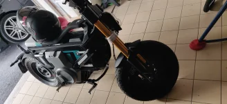

Just checked to see if the regen display goes all the way to left when we have full power. See pics below for stages
Thanks... For what i can tell the regen rectangle does not extend completely to the left in any of the pictures.
Is that in Flash mode?
On mine it used to go all the way before they updated the firmware...
BTW: i think you can actually see that briefly at startup when the display comes to life first, and then adjusts itself with the current status.
Hi, yes that was in flash mode. I’m going assume mine had the latest software update before I received it. Also the issue with the bike starting etc is down the button cluster on the left hand side, the power button is faulty and giving out the wrong signal or not at all. The bike had its running in service yesterday and it was diagnosed at the time, I’m having to wait for 2 weeks for a replacement to be delivered to BMW Motorrad and then fitted under warranty. Also today I received the rear view mirrors, let me know what you all think.
